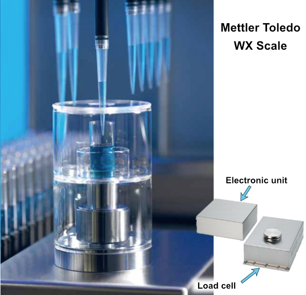

shaker
Figure: Mettler Toledo WXS205SDU used for gravimetric liquid transfer verification

The WXS205SDU scale system consists of 2 required units and 1 optional unit:
Machine Components#
1. Load Cell
2. Electronic Unit
3. Terminal/Display
load_cell
electronic_unit
terminal
The weighing platform where samples are placed
The control and communication module
Optional: For manual reading of measurements
