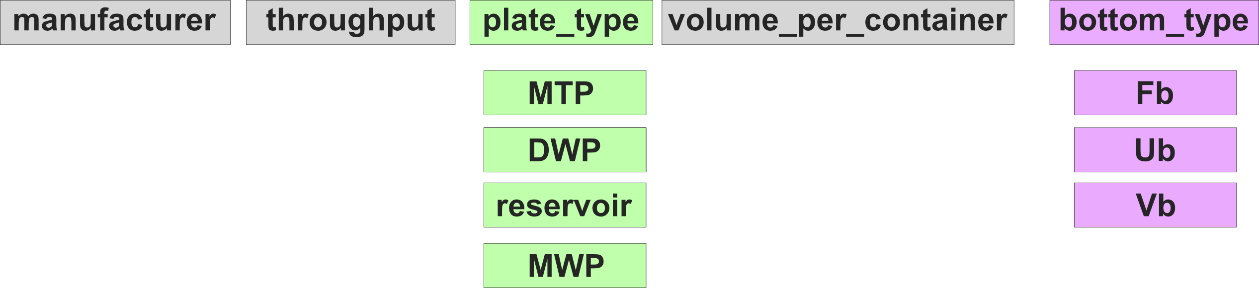

PLR is not actively enforcing a specific plate naming standard but recommends the following:
PLR plate naming standards
This standard is similar to the Opentrons API labware naming standard but:
  1. Further sub-categorizes “wellplates” to facilitate communication with day-to-day users, and
  2. Adds information about the well-bottom geometry.
(WIP)

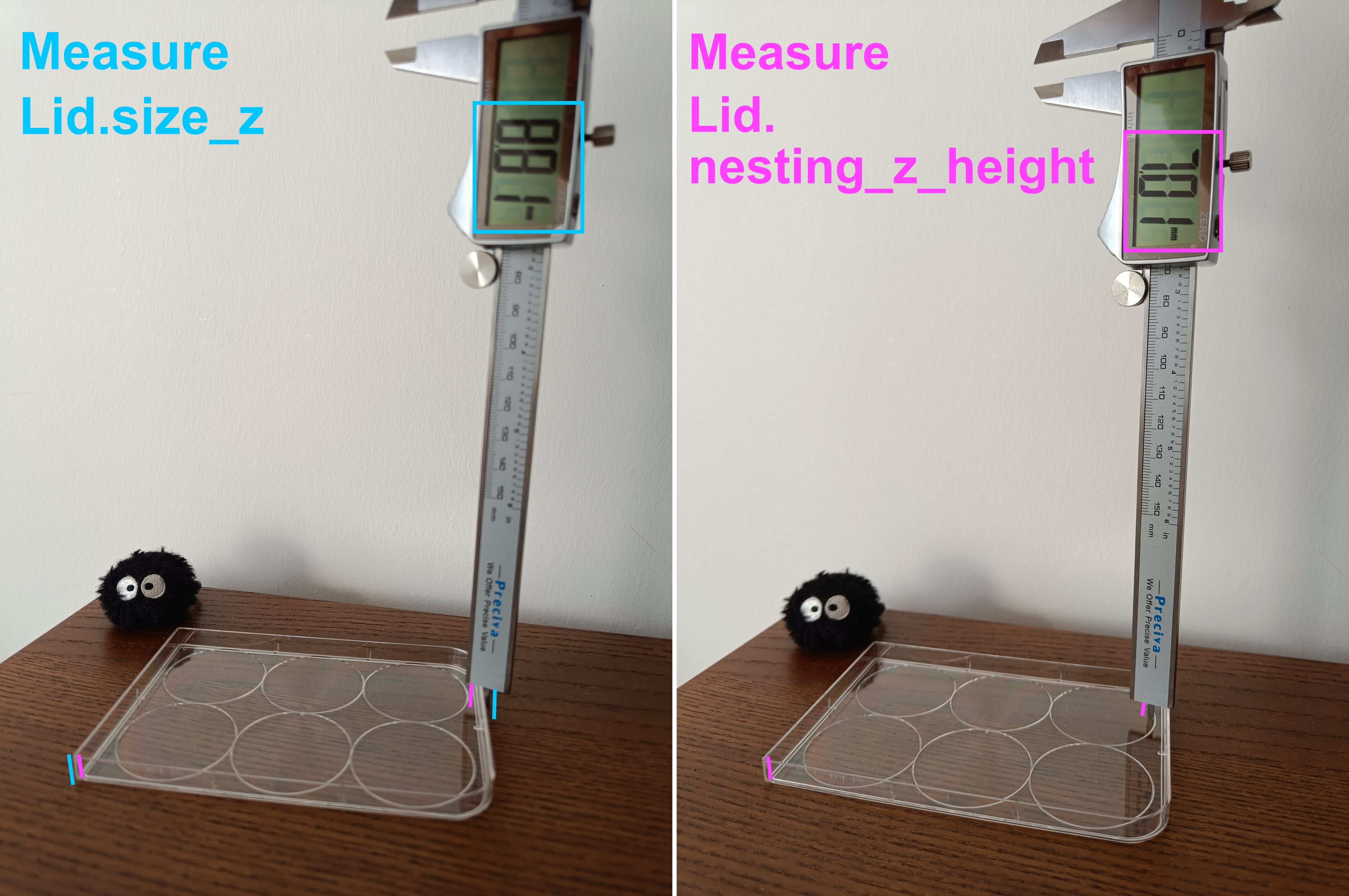

Measuring nesting_z_height#
The nesting_z_height is the overlap between the lid and the plate when the lid is placed on the plate. This property can be measured using a caliper.
nesting_z_height measurement
