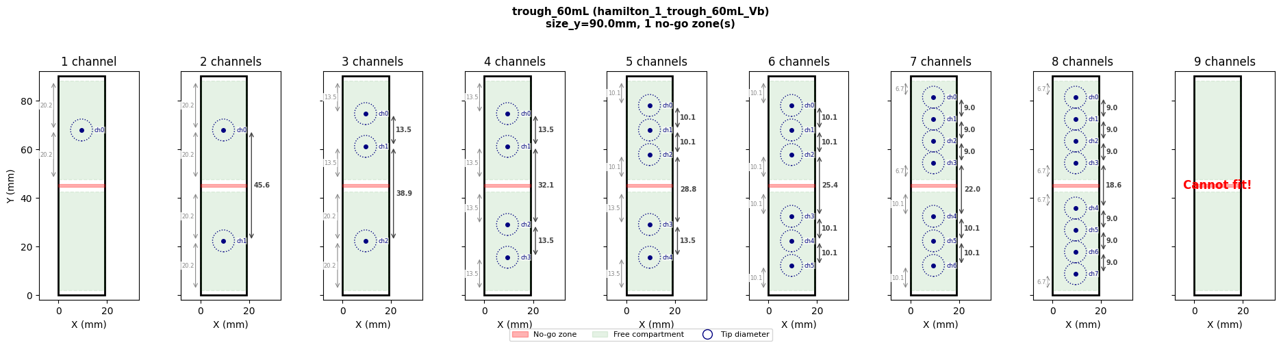

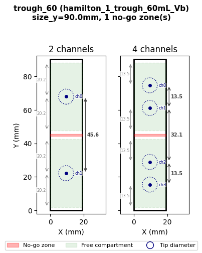

60 mL trough - 1 center divider#
The hamilton_1_trough_60mL_Vb has a single center support wall (~1.2mm wide), creating 2 compartments.
from pylabrobot.resources.hamilton.troughs import hamilton_1_trough_60mL_Vb
trough_60 = hamilton_1_trough_60mL_Vb(name="trough_60mL")
print(f"Container: {trough_60.name}, size_y={trough_60.get_absolute_size_y()}mm")
print(f"No-go zones: {trough_60.no_go_zones}")
print(f"Compartments: {_get_compartments(trough_60)}")
plot_container_cross_section(trough_60, [1, 2, 3, 4, 5, 6, 7, 8, 9])
Container: trough_60mL, size_y=90.0mm
No-go zones: [(Coordinate(x=0, y=44.4, z=5.0), Coordinate(x=19.0, y=45.6, z=60.25))]
Compartments: [(2.0, 42.4), (47.6, 88.0)]
../../_images/f4e1600a2aa10ede32f359d07db191617dee82a0109b9e136de7073ffe69c9c7.png

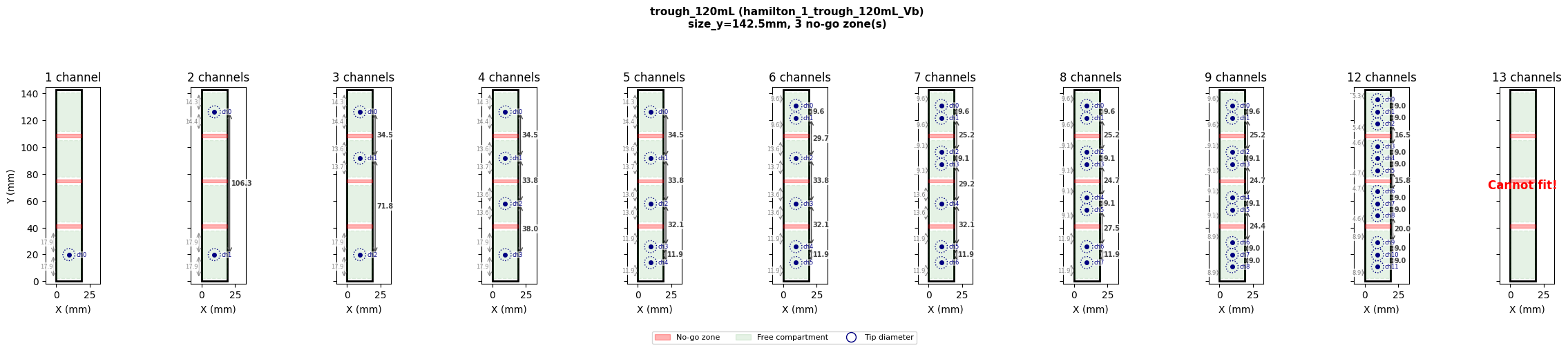

The hamilton_1_trough_120mL_Vb has 3 internal support beams (~2.5mm wide at the base, ~0.8mm at the top), creating 4 compartments. The no-go zones use the base width since that is the worst case for pipette tip clearance.
Dimensional breakdown (from outer y=0):
Element
Y range (mm)
Size (mm)
Modelled as
Back wall
141.1 - 142.5
1.4
Not modelled (included in size_y)
Compartment 3
109.8 - 141.1
31.3
Free space
Beam 3
107.3 - 109.8
2.5
no_go_zones[2]
Compartment 2
76.0 - 107.3
31.3
Free space
Beam 2
73.5 - 76.0
2.5
no_go_zones[1]
Compartment 1
42.2 - 73.5
31.3
Free space
Beam 1
39.7 - 42.2
2.5
no_go_zones[0]
Compartment 0
1.2 - 39.7
38.5
Free space
Front wall
0 - 1.2
1.2
Note
size_y=142.5is the **outer** dimension of the trough. The front and back walls are not modelled as no-go zones - they are accounted for by theedge_clearance` parameter during channel positioning.
The internal beams are modelled as no-go zones because they obstruct pipette access within the container’s interior.
from pylabrobot.resources.hamilton.troughs import hamilton_1_trough_120mL_Vb
trough_120 = hamilton_1_trough_120mL_Vb(name="trough_120mL")
print(f"Container: {trough_120.name}, size_y={trough_120.get_absolute_size_y()}mm")
print(f"No-go zones: {trough_120.no_go_zones}")
print(f"Compartments: {_get_compartments(trough_120)}")
plot_container_cross_section(trough_120, [1, 2, 3, 4, 5, 6, 7, 8, 9, 12, 13])
Container: trough_120mL, size_y=142.5mm
No-go zones: [(Coordinate(x=0, y=39.7, z=12.0), Coordinate(x=19.0, y=42.2, z=70.0)), (Coordinate(x=0, y=73.5, z=12.0), Coordinate(x=19.0, y=76.0, z=70.0)), (Coordinate(x=0, y=107.3, z=12.0), Coordinate(x=19.0, y=109.8, z=70.0))]
Compartments: [(2.0, 37.7), (44.2, 71.5), (78.0, 105.3), (111.8, 140.5)]
../../_images/4b2ca7d42452c653dce09bf242d4ff912f2094065a3c4235fea817a1450a4909.png

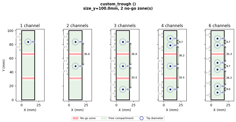

Defining no-go zones on a new container#
Any Container (or subclass: Trough, Well, Tube, etc.) accepts a no_go_zones parameter. Each zone is a pair of Coordinates - the front-left-bottom and back-right-top corners of the obstructed cuboid, relative to the container’s outer origin.
from pylabrobot.resources.trough import Trough, TroughBottomType
# Define a custom trough with two dividers
custom_trough = Trough(
    name="custom_trough",
    size_x=19.0,
    size_y=100.0,
    size_z=50.0,
    max_volume=80_000,
    bottom_type=TroughBottomType.V,
    no_go_zones=[
        (Coordinate(0, 30.0, 0), Coordinate(19.0, 32.0, 50.0)),  # divider 1
        (Coordinate(0, 65.0, 0), Coordinate(19.0, 67.0, 50.0)),  # divider 2
print(f"Container: {custom_trough.name}, size_y={custom_trough.get_absolute_size_y()}mm")
print(f"Compartments: {_get_compartments(custom_trough)}")
plot_container_cross_section(custom_trough, [1, 2, 3, 4, 6])
Container: custom_trough, size_y=100.0mm
Compartments: [(2.0, 28.0), (34.0, 63.0), (69.0, 98.0)]
../../_images/ac4b25d0c92d4425636bbb9a372cee7c0391b6479550537acdb5203a77773e01.png

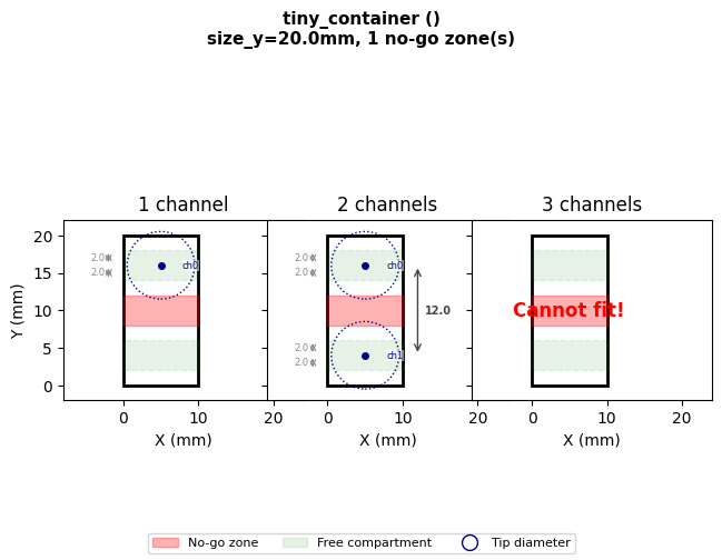

It does not prevent a pipette from entering a container. Whether a tip physically fits is determined by tip diameter vs. container opening - e.g. a 1000 µL tip won’t fit into a 1536-wellplate well. This is the user’s responsibility to verify when choosing tips and containers.
# A narrow container where compartments are smaller than the default 9mm channel spacing.
# 1 channel per compartment still works - the channel is simply centered.
# 2 channels in one compartment would fail (needs 9mm, only 4mm available).
from pylabrobot.lib.liquid_handling.errors import ChannelsDoNotFitError
tiny = Container(
    name="tiny_container", size_x=10, size_y=20, size_z=10,
    no_go_zones=[(Coordinate(0, 8, 0), Coordinate(10, 12, 10))],
print(f"Container size_y: {tiny.get_absolute_size_y()}mm")
print(f"No-go zone: Y={8}-{12}mm -> two 8mm raw compartments")
print(f"After 2mm edge clearance: compartments = {_get_compartments(tiny)}")
print(f"1 channel: {compute_channel_offsets(tiny, 1)}")
print(f"2 channels (1 per compartment): {compute_channel_offsets(tiny, 2)}")
try:
    print(f"3 channels: {compute_channel_offsets(tiny, 3)}")
except ChannelsDoNotFitError as e:
    print(f"3 channels (needs 2 in one 4mm compartment): ChannelsDoNotFitError - {e}")
plot_container_cross_section(tiny, [1, 2, 3])
Container size_y: 20.0mm
No-go zone: Y=8-12mm -> two 8mm raw compartments
After 2mm edge clearance: compartments = [(2.0, 6.0), (14.0, 18.0)]
1 channel: [Coordinate(x=0, y=6.0, z=0)]
2 channels (1 per compartment): [Coordinate(x=0, y=6.0, z=0), Coordinate(x=0, y=-6.0, z=0)]
3 channels (needs 2 in one 4mm compartment): ChannelsDoNotFitError - Cannot distribute channels across compartments while respecting spacing constraints.

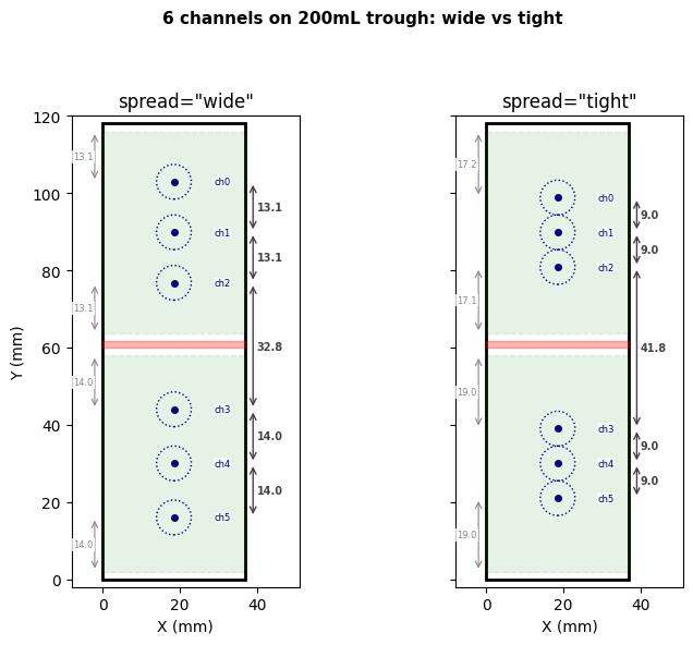

Spread modes with no-go zones#
The spread parameter on aspirate and dispense controls how channels are positioned within each compartment:
  • spread="wide" (default) - channels are spread as far apart as possible within each compartment
  • spread="tight" - channels are packed at minimum spacing (9mm), centered in each compartment
  • spread="custom" - no-go zones are ignored entirely; the user controls all positioning via offsets
# Compare wide vs tight spread on the 200mL trough (2 large compartments, 6 channels)
from pylabrobot.resources.hamilton.troughs import hamilton_1_trough_200mL_Vb
trough_200 = hamilton_1_trough_200mL_Vb(name="trough_200mL")
print(f"Compartments: {_get_compartments(trough_200)}")
for mode in ["wide", "tight"]:
    offsets = compute_channel_offsets(trough_200, 6, spread=mode)
    positions = [f"{o.y:+.1f}" for o in offsets]
    print(f"spread={mode!r:8s} -> offsets (from center): {positions}")
Compartments: [(2.0, 58.0), (63.7, 116.0)]
spread='wide'   -> offsets (from center): ['+43.9', '+30.9', '+17.8', '-15.0', '-29.0', '-43.0']
spread='tight'  -> offsets (from center): ['+39.9', '+30.9', '+21.9', '-20.0', '-29.0', '-38.0']
plot_spread_comparison(trough_200, 6, title="6 channels on 200mL trough: wide vs tight")
../../_images/a83373282e7bfe18ac1488efdefd356871132ea819f3d97d0ddf8b3634381e09.png

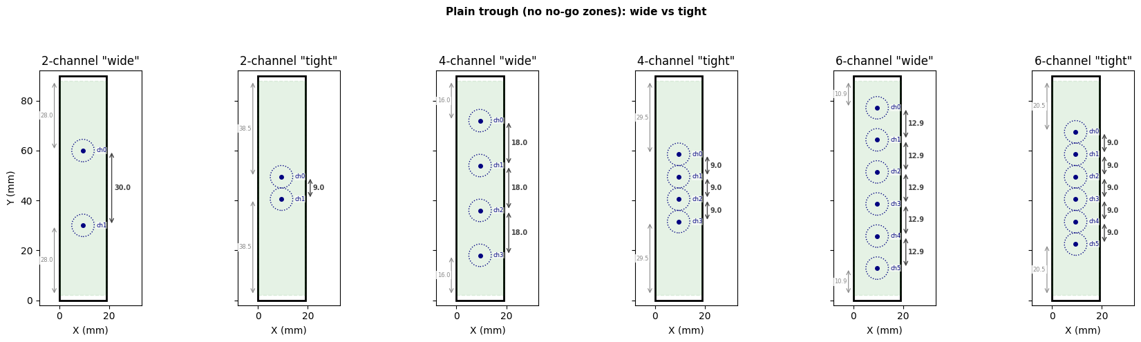

Container without no-go zones#
compute_channel_offsets also works on plain containers. Without no-go zones, it falls through to standard wide/tight spread across the full Y axis.
# A plain trough without no-go zones
plain_trough = Trough(
    name="plain_trough",
    size_x=19.0,
    size_y=90.0,
    size_z=65.0,
    max_volume=60_000,
for n in [2, 4, 6]:
        offsets = compute_channel_offsets(plain_trough, n, spread=mode)
        print(f"{n}-channel {mode:6s} -> {positions}")
# Side-by-side: wide vs tight for 2, 4, 6 channels
channel_counts = [2, 4, 6]
n_pairs = len(channel_counts)
fig, axes = plt.subplots(1, n_pairs * 2, figsize=(3 * n_pairs * 2, 5), squeeze=False)
axes = axes[0]
for pair_idx, n_ch in enumerate(channel_counts):
    for mode_idx, mode in enumerate(["wide", "tight"]):
        ax = axes[pair_idx * 2 + mode_idx]
        _draw_container_axis(ax, plain_trough, n_ch, spread=mode)
        ax.set_title(f'{n_ch}-channel "{mode}"')
        if pair_idx == 0 and mode_idx == 0:
            ax.set_ylabel("Y (mm)")
        else:
            ax.set_yticklabels([])
fig.suptitle("Plain trough (no no-go zones): wide vs tight", fontsize=11, fontweight="bold")
fig.tight_layout(rect=[0, 0, 1, 0.93])
fig.subplots_adjust(wspace=-0.05)
plt.show()
2-channel wide   -> ['+15.0', '-15.0']
2-channel tight  -> ['+4.5', '-4.5']
4-channel wide   -> ['+27.0', '+9.0', '-9.0', '-27.0']
4-channel tight  -> ['+13.5', '+4.5', '-4.5', '-13.5']
6-channel wide   -> ['+32.1', '+19.3', '+6.4', '-6.4', '-19.3', '-32.1']
6-channel tight  -> ['+22.5', '+13.5', '+4.5', '-4.5', '-13.5', '-22.5']
../../_images/8af16ce2f6b3b61f6e37f4fc04e824e173b6d822d632456a381baf1b6b87ee36.png

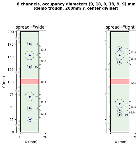

Per-channel occupancy diameters#
Each channel has an occupancy diameter - the physical space it takes up. On a Hamilton STAR, 1mL channels have a 9mm occupancy diameter, while 5mL channels have 18mm. The required gap between two adjacent channels is the sum of their radii: spacing[i]/2 + spacing[j]/2.
compute_channel_offsets accepts channel_spacings - one occupancy diameter per channel - and computes all gaps accordingly.
# 6 channels with mixed occupancy diameters on a wide demo trough
# 4 channels with 9mm occupancy (1mL), 2 with 18mm occupancy (5mL) - e.g. mixed Hamilton
mixed_spacings = [9.0, 18.0, 9.0, 18.0, 9.0, 9.0]  # 6 occupancy diameters for 6 channels
# Create a wider trough to clearly show the difference between wide and tight
demo_trough = Trough(
    name="demo_trough",
    size_x=37.0,
    size_y=200.0,
    size_z=95.0,
    max_volume=200_000,
    no_go_zones=[
        (Coordinate(0, 95, 0), Coordinate(37.0, 105, 95.0)),  # center divider
print(f"Compartments: {_get_compartments(demo_trough)}")
    offsets = compute_channel_offsets(demo_trough, 6, spread=mode, channel_spacings=mixed_spacings)
    centers = sorted([demo_trough.get_size_y() / 2 + o.y for o in offsets])
    gaps = [round(centers[i + 1] - centers[i], 1) for i in range(len(centers) - 1)]
    print(f"spread={mode!r:8s}  centers={[f'{c:.1f}' for c in centers]}  gaps={gaps}")
    demo_trough, 6,
    title="6 channels, occupancy diameters [9, 18, 9, 18, 9, 9] mm\n(demo trough, 200mm Y, center divider)",
    channel_spacings=mixed_spacings,
Compartments: [(2.0, 93.0), (107.0, 198.0)]
spread='wide'    centers=['24.8', '47.5', '70.2', '129.8', '152.5', '175.2']  gaps=[22.8, 22.8, 59.5, 22.8, 22.8]
spread='tight'   centers=['34.0', '43.0', '56.5', '139.0', '152.5', '166.0']  gaps=[9.0, 13.5, 82.5, 13.5, 13.5]
../../_images/3ebeb1524e6860b46321075d5a0c9862da468fb1a08a85163e66155a1a079715.png

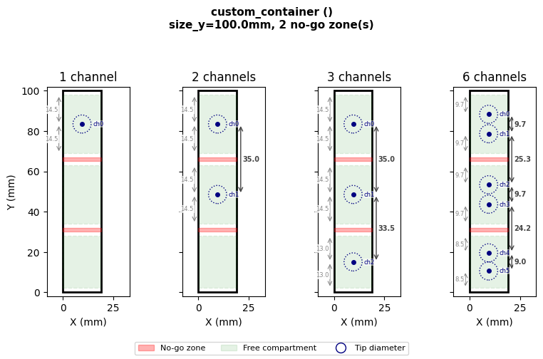

Try it yourself#
Edit the parameters below to experiment with any container geometry:
# --- Edit these ---
CONTAINER_SIZE_X = 19.0   # mm
CONTAINER_SIZE_Y = 100.0  # mm
CONTAINER_SIZE_Z = 50.0   # mm
# List of (y_start, y_end) pairs for no-go zones
NO_GO_Y_RANGES = [
    (30, 32),   # divider 1
    (65, 67),   # divider 2
NUM_CHANNELS = [1, 2, 3, 6]  # channel counts to plot
no_go_zones = [
    (Coordinate(0, y_lo, 0), Coordinate(CONTAINER_SIZE_X, y_hi, CONTAINER_SIZE_Z))
    for y_lo, y_hi in NO_GO_Y_RANGES
custom = Container(
    name="custom_container",
    size_x=CONTAINER_SIZE_X,
    size_y=CONTAINER_SIZE_Y,
    size_z=CONTAINER_SIZE_Z,
    no_go_zones=no_go_zones,
print(f"Compartments: {_get_compartments(custom)}")
for n in NUM_CHANNELS:
    try:
        result = compute_channel_offsets(custom, n)
        status = [f"y={o.y:+.1f}" for o in result]
    except ChannelsDoNotFitError:
        status = "Cannot fit"
    print(f"  {n} ch: {status}")
plot_container_cross_section(custom, NUM_CHANNELS)
  1 ch: ['y=+33.5']
  2 ch: ['y=+33.5', 'y=-1.5']
  3 ch: ['y=+33.5', 'y=-1.5', 'y=-35.0']
  6 ch: ['y=+38.3', 'y=+28.7', 'y=+3.3', 'y=-6.3', 'y=-30.5', 'y=-39.5']
../../_images/18476ea41a621e18bbcd4381e6fd9abe860d47beb8c760786d39b984655763be.png

Aspirate with 2 and 4 channels#
Pick up tips, fill the trough, then aspirate. The chatterbox backend prints raw firmware commands - the yp values show absolute Y positions in 0.1mm units. Verify that channels land in separate compartments and avoid the divider at Y=44-46mm.
tip_rack = deck.get_resource("tips_1000")
await lh.pick_up_tips(tip_rack["A1:D1"])
trough.tracker.set_volume(50_000)
# Show expected offsets before aspirating
for n in [2, 4]:
    offsets = compute_channel_offsets(trough, n)
    print(f"{n} channels -> offsets: {[f'{o.y:+.1f}mm' for o in offsets]}")
plot_container_cross_section(trough, [2, 4])
C0TTid0001tt01tf1tl0871tv10650tg3tu0
C0TPid0002xp01179 01179 01179 01179 00000&yp1458 1368 1278 1188 0000&tm1 1 1 1 0&tt01tp2266tz2166th2450td0
2 channels -> offsets: ['+22.8mm', '-22.8mm']
4 channels -> offsets: ['+29.5mm', '+16.1mm', '-16.1mm', '-29.5mm']
../../_images/244dcf132fbbc9ab4daf362ed6c9e19db5edf9ca3e1022d1ee9720a0e4943ac0.png
