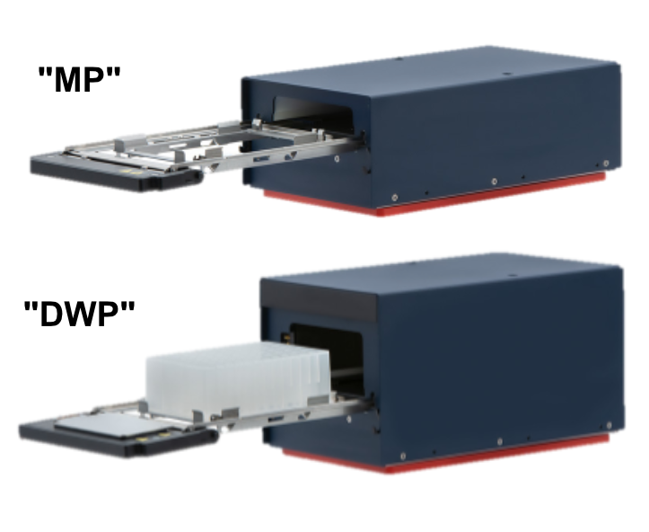

Figure: Inheco Incubator Shaker MP & DWP models
About the Machine(s)#
Inheco incubator shakers are modular machines used for plate storage, temperature control and shaking. They differentiate themselves:
  • heater shakers … heat a material on which a plate is being placed; open-access; non-uniform temperature distribution around the plate; enables shaking of plate.
  • incubator shakers … an enclosed chamber that is being heated and houses a plate; plate access is controlled via a loading tray and a door; highly uniform temperature distribution around the plate; enables shaking of plate.
The Inheco incubator devices come in 4 versions, dependent on (1) whether they provide a shaking feature & (2) the size of plates they accept:

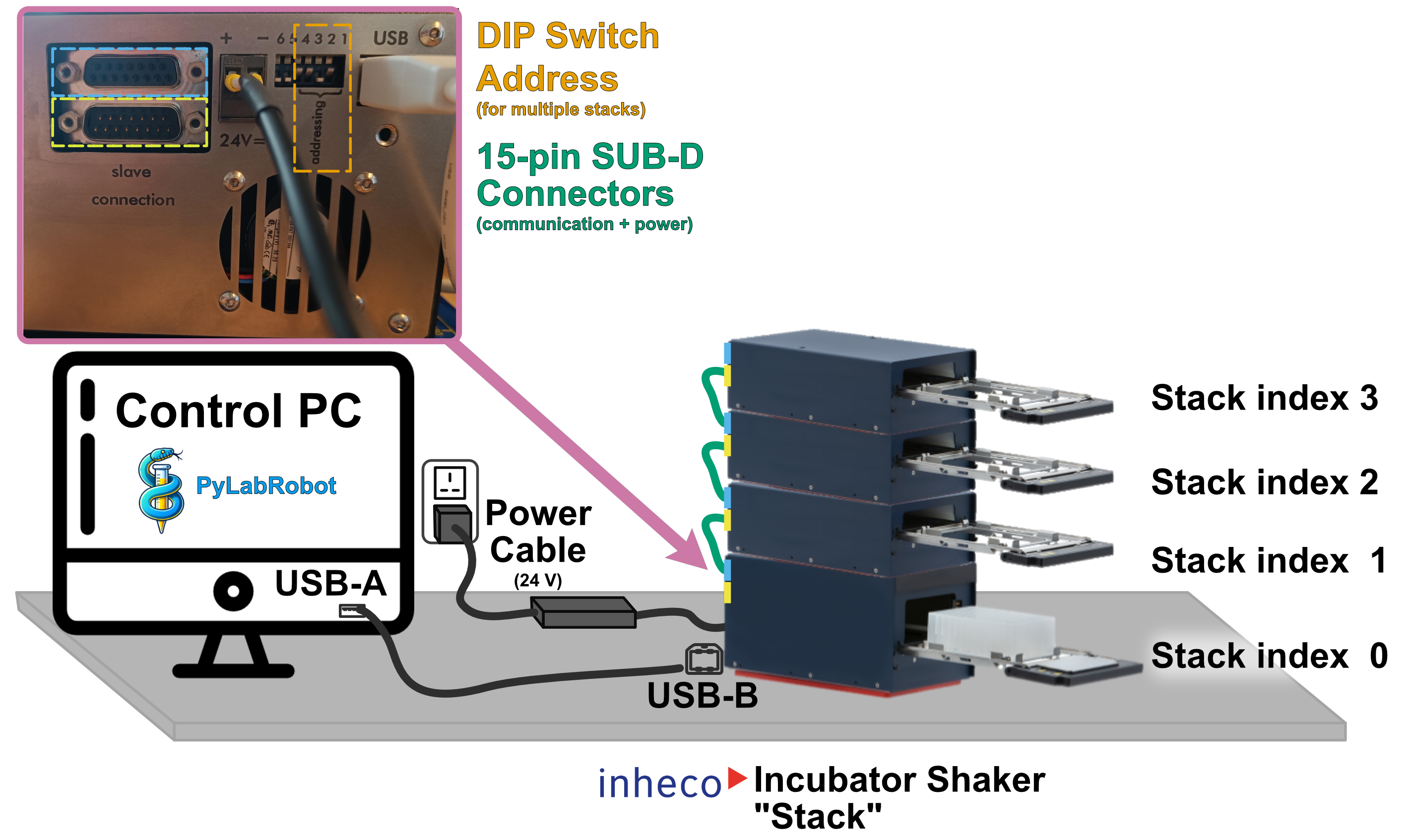

Setup Instructions (Physical)#
copy-me
To facilitate integration, multiple devices can be placed on top of each other to form an Incubator Shaker Stack (see infographic above), but care has to be taken to not overstrain the connections:
Each of the 4 different shaker types requires a different amount of power. An easier way to identify the configurations possible is to think of “incubator power credits” - no stack must exceed 5 power credits (see User and Installation Manual):
  1. An “incubator MP” -> 1 “incubator power credits” -> 5 units can be stacked on top of each other.
  2. An “incubator DWP” -> 1.25 “incubator power credits” -> 4 units.
  3. An “incubator shaker MP” -> 1.6 “incubator power credits” -> 3 units
  4. An “incubator shaker DWP” -> 2.5 “incubator power credits” -> 2 units
However, the machines in a single stack can be of any of the 4 types. This means you could create stacks of:
  • 2x “incubator DWP” (1.25 credits) + 1x “incubator shaker DWP” (2.5 credits)
  • 3x “incubator MP” (1 credits) + 1x “incubator shaker MP” (1.6 credits) [shown in the infographic above]
When a stack would exceed more than 5 “incubator power credits”, you must build multiple stacks (ask your Inheco sales representative if you are unsure before trying this out).
The benefit of this setup is that only one power cable and only one USB cable have to be plugged into the machine at the very bottom of a machine (i.e. stack index 0). Machines above the bottom one only need to be connected with the machine below it using the 15-pin SUB-D connectors that come with each machine when bought from Inheco.
Note
Note: In PyLabRobot, the stack is the central control element and is controlled via its own instance of the InhecoIncubatorShakerStackBackend.
Explanation

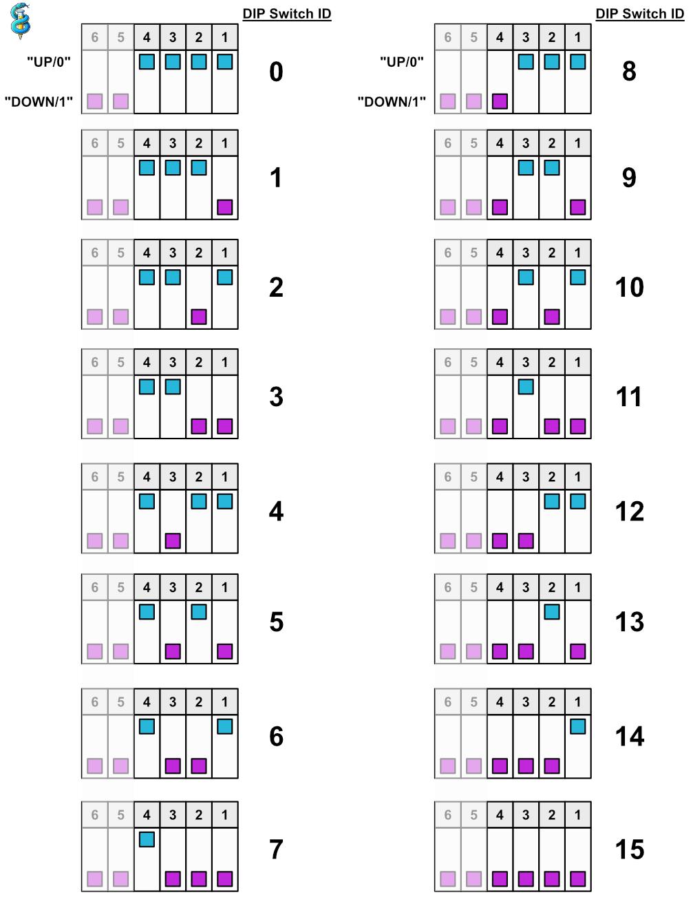

To connect an InhecoIncubatorShakerStackBackend you must set the DIP switch identifier on the back of the bottom machine:
  • located on the back of the bottom machine,
  • defines the DIP switch configuration for the entire stack.
Setting the DIP switch to generate a machine address
Each machine has a 4-pin DIP switch. Each pin can be UP (0) or DOWN (1).
Note: the two pins to the left of the DIP switch are not part of the addressing and should remain in the DOWN position.
This forms a 4-bit binary address:
  • All pins at 0 → binary 0 0 0 0 → decimal 0
  • All pins at 1 → binary 1 1 1 1 → decimal 15 (24-1)
This address is crucial for generating valid communication commands for your Inheco stack.
dip switches
Figure: DIP switch layout to generate different identifiers/addresses

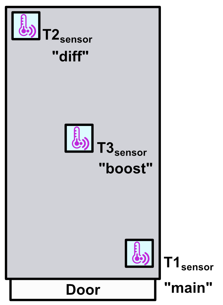

The Inheco Incubator (Shaker) contains three independent temperature sensors:
  1. main sensor — close to the door/front, inside the machine
  2. validation sensor — back, inside the machine
  3. boost sensor — on heating foil, inside the machine
By default, iis_stack[0].get_temperature()’s argument is set to sensor=”main”.
This can be changed to any of the following:
  • ”main”
  • ”dif”
  • ”boost”
  • ”mean” — takes all three sensors’ measurements and returns their geometric mean
sensor positions
Figure: Inheco Incubator Shaker Temperature Sensor Positioning

Self Test / Maintenance (PLR beta)#
The Inheco firmware provides a “self-test” which checks the drawer, temperature and shaking features. This test can take up to 5 min.
The test must be performed without a plate in the incubator.
It generates a binary code in which each position represents a machine subsystem:
  • Bit 0: Drawer
  • Bit 1: Homogeneity Sensor 3 versus Sensor 1 (>2 K)
  • Bit 2: Homogeneity Sensor 2 versus Sensor 1 (>2 K)
  • Bit 3: Sensor 1 doesn’t reach Target Temperature after 130 sec.
  • Bit 4: Y-Amplitude Shaker
  • Bit 5: X-Amplitude Shaker
  • Bit 6: Phase Shift Shaker
  • Bit 7: Y-Frequency Shaker
  • Bit 8: X-Frequency Shaker
  • Bit 9: Line Boost-Heater broken
  • Bit 10: Line Main-Heater broken
A 0 means no error has been found for that subsystem, and a 1 means there is a hardware fault.

Usage: Master Control via the Stack Frontend 🦾#
Even though loops make setting temperatures fast and efficient, we found it is too much code.
This is why we enabled the frontend to have “master control commands” for all units in a stack.

Usage: Multiple Stacks#
To connect more than one machine stack:
  • instantiate a separate backend and frontend for each,
  • you must hand the serial port to each stack’s backend explicitly
Note
When using one stack, PyLabRobot finds the machine’s port automatically based on its unique VID:PID, if multiple machines are found with the same VID:PID there is ambiguity
  • e.g. the VSpin & Cytation 5 use the same identifier combo :’)
  • perform a setup for each stack.
(set on the back of the bottom-most machine):
iis_stack_backend_0 = InhecoIncubatorShakerStackBackend(dip_switch_id = 2, port="/dev/cu.usbserial-130")
iis_stack_0 = IncubatorShakerStack(backend=iis_stack_backend_0)
