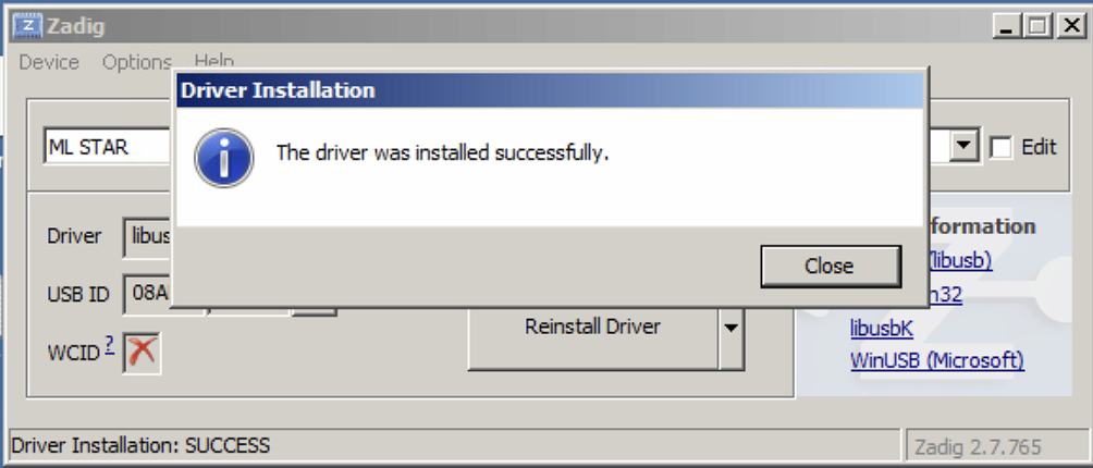

  1. Download and install Zadig.
  2. Make sure the Hamilton is connected using the USB cable and that no other Hamilton/VENUS software is running.

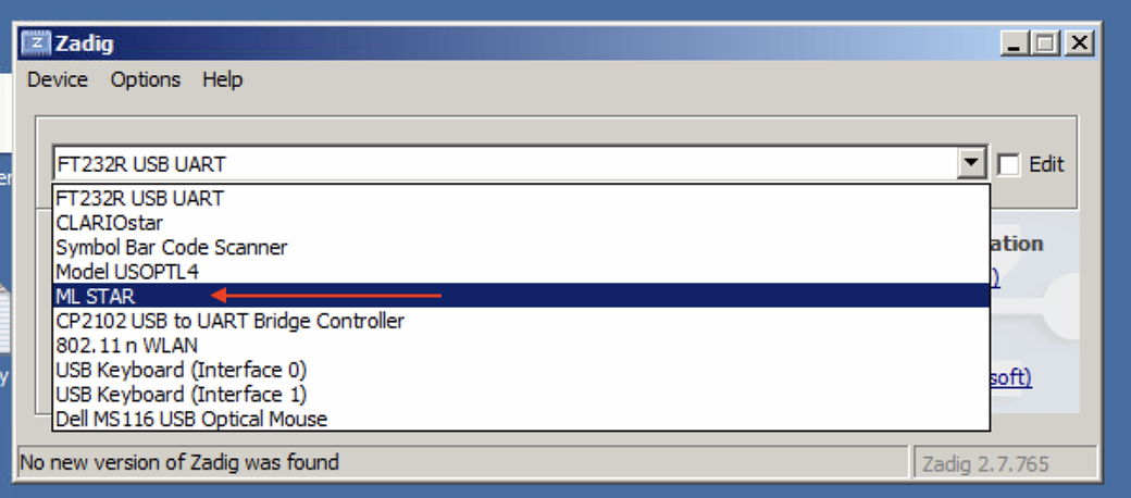

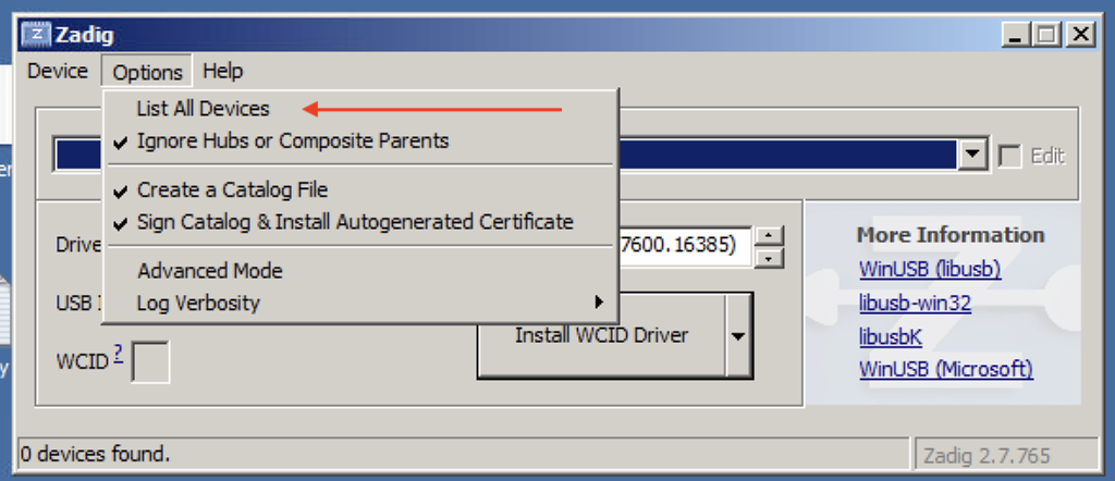

  3. Open Zadig and select “Options” -> “List All Devices”.
  1. Select “ML Star” from the list if you’re using a Hamilton STAR or STARlet. If you’re using a Tecan robot, select “TECU”.

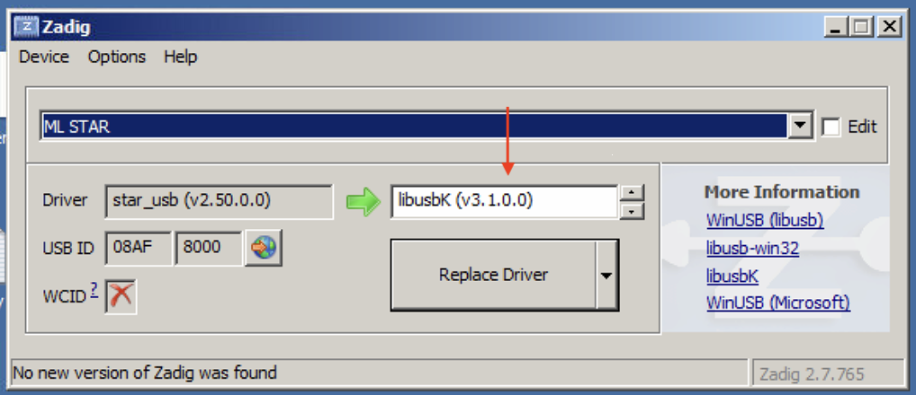

  1. Select “libusbK” using the arrow buttons.

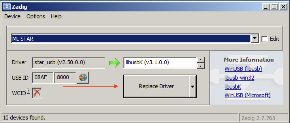

  1. Click “Replace Driver”.
  1. Click “Close” to finish.

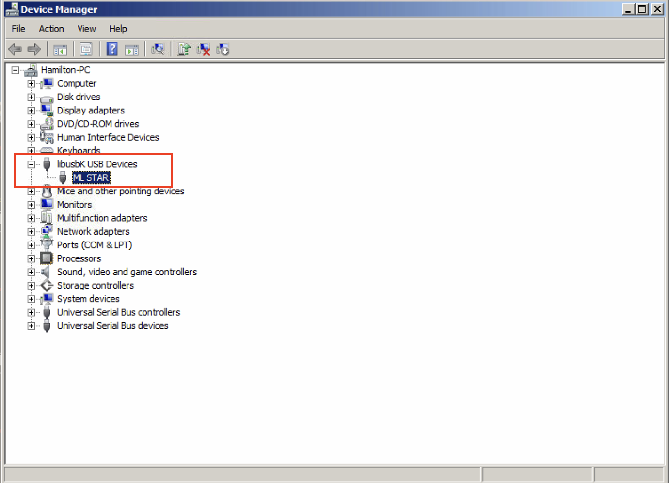

If you ever wish to switch back from firmware command to use pyhamilton or plain VENUS, you have to replace the updated driver with the original Hamilton or Tecan one.

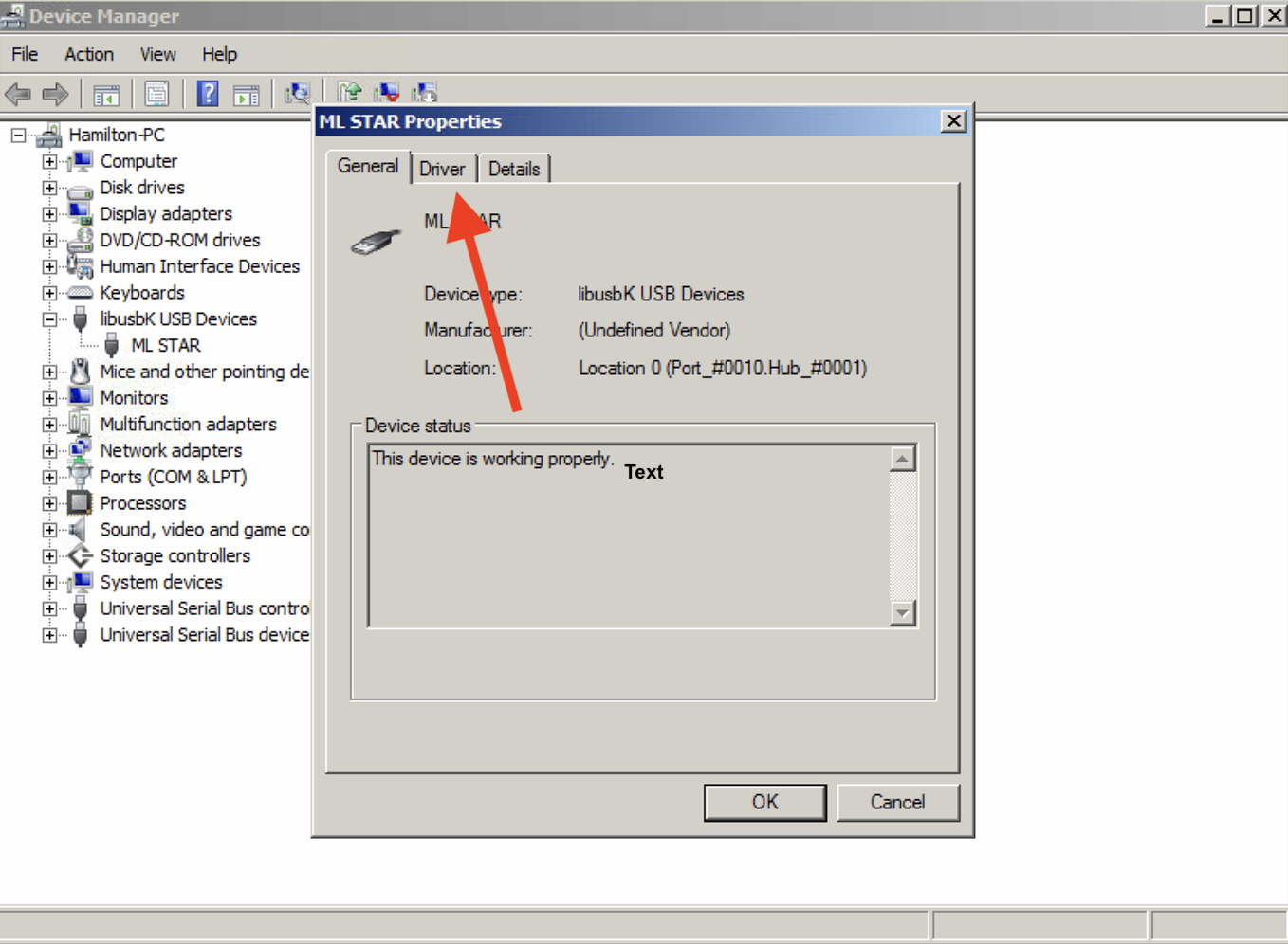

  1. This guide is only relevant if ML Star is listed under libusbK USB Devices in the Device Manager program.

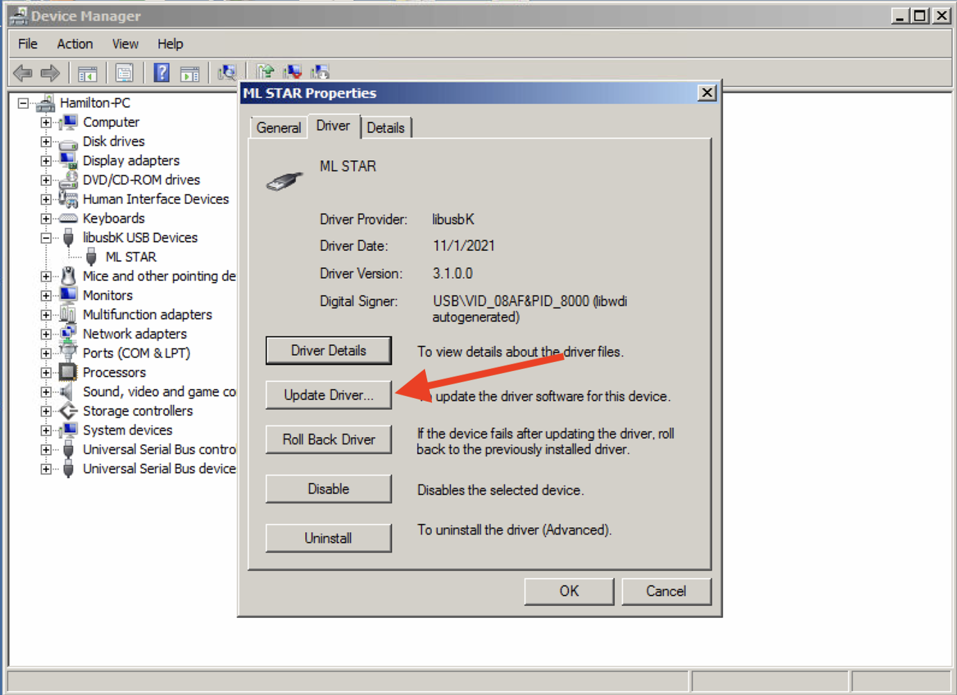

  1. If that”s the case, double click “ML Star” (or similar) to open this dialog, then click “Driver”.
  1. Click “Update Driver”.

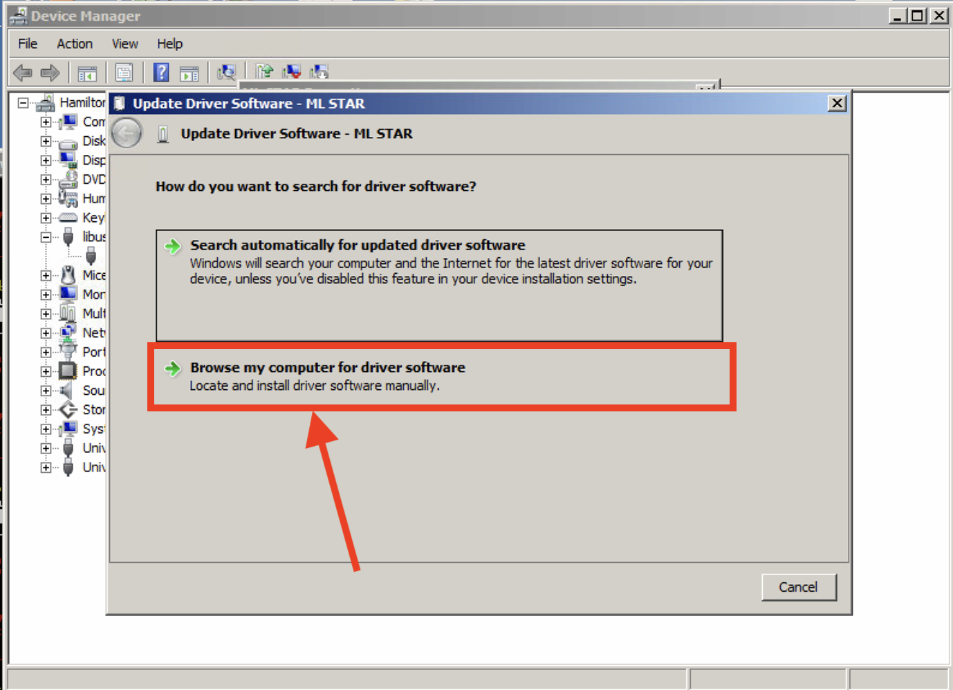

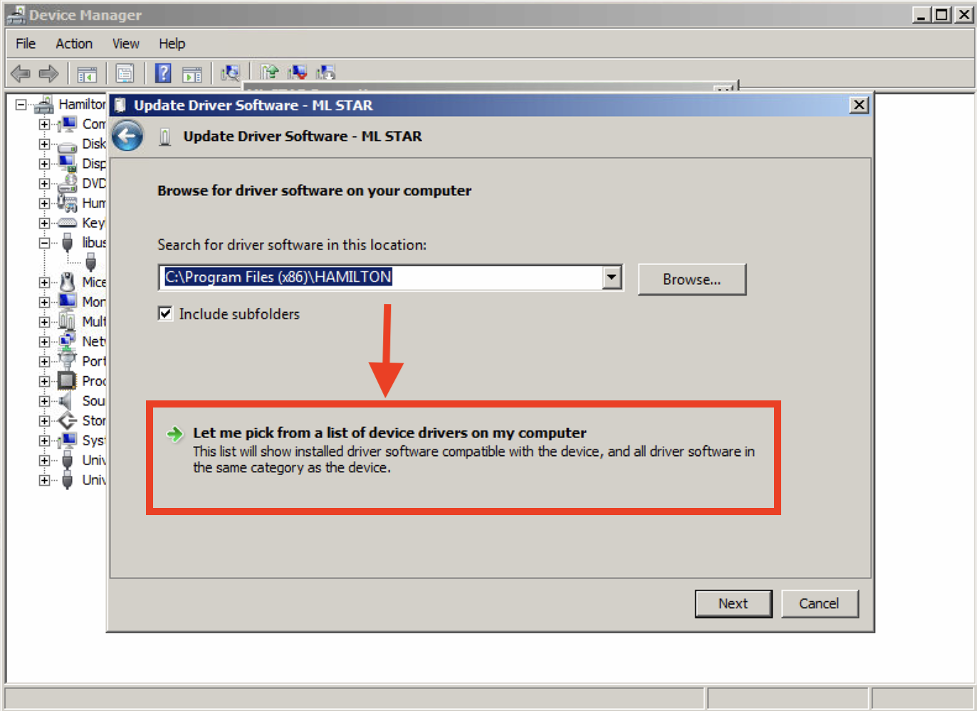

  1. Select “Browse my computer for driver software”.

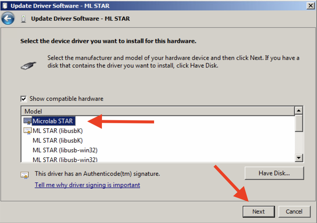

  1. Select “Let me pick from a list of device drivers on my computer”.

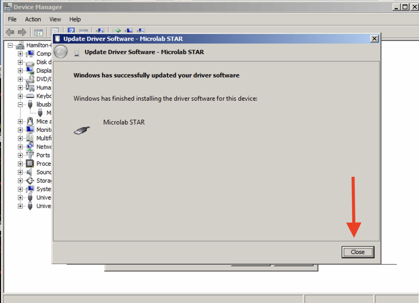

  1. Select “Microlab STAR” and click “Next”.
