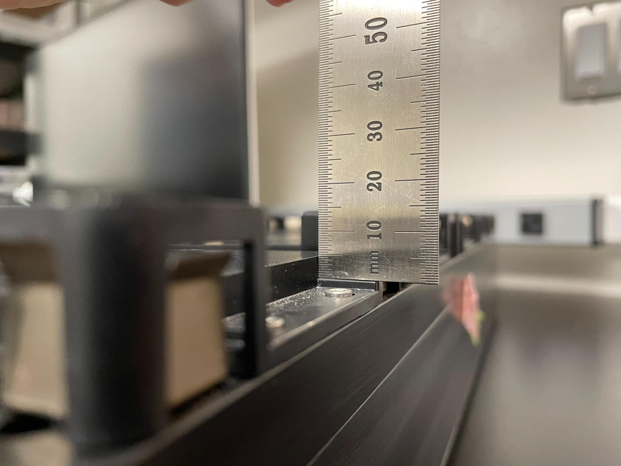

Here’s how you measure the pedestal height using a ruler or caliper:
Pedestal height measurement
To explain what is happening in the image above: you measure the difference between the pedestal top and the top of the second highest surface: the surface that the plate would sit on if it had a very high clearance below its wells (i.e. a very high dz value). It is measured from the top of the pedestal to the top of the second highest surface, so it is a negative value. In some cases, the second highest surface is actually a small ridge, not the bigger outer edge of the plate holder. If that is the case, you measure from the top of the pedestal to the top of that ridge.
