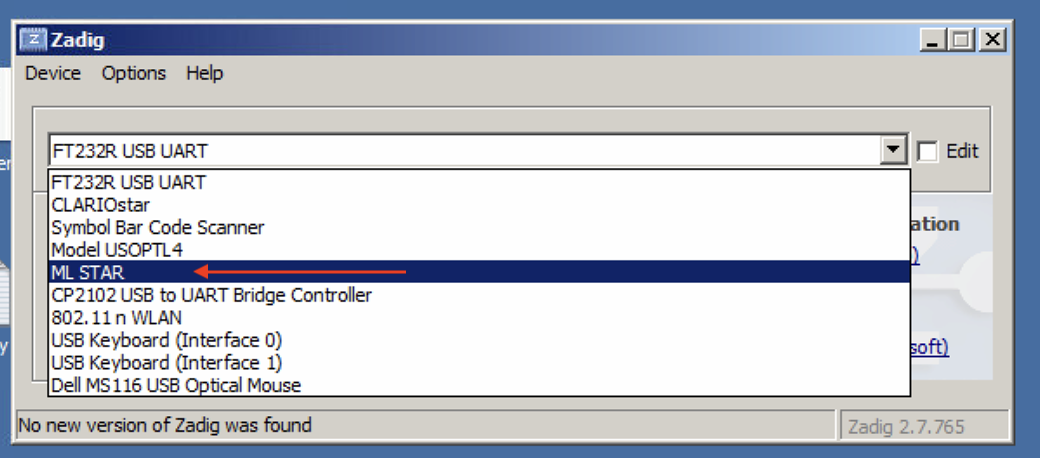

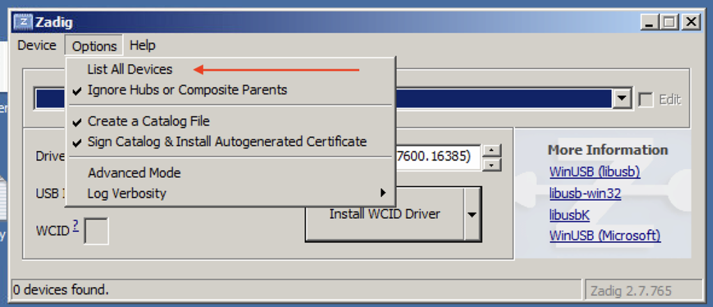

  3. Open Zadig and select “Options” -> “List All Devices”.

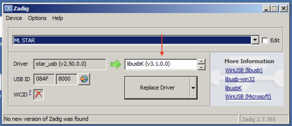

  1. Select “ML Star” from the list if you’re using a Hamilton STAR or STARlet. If you’re using a Tecan robot, select “TECU”.

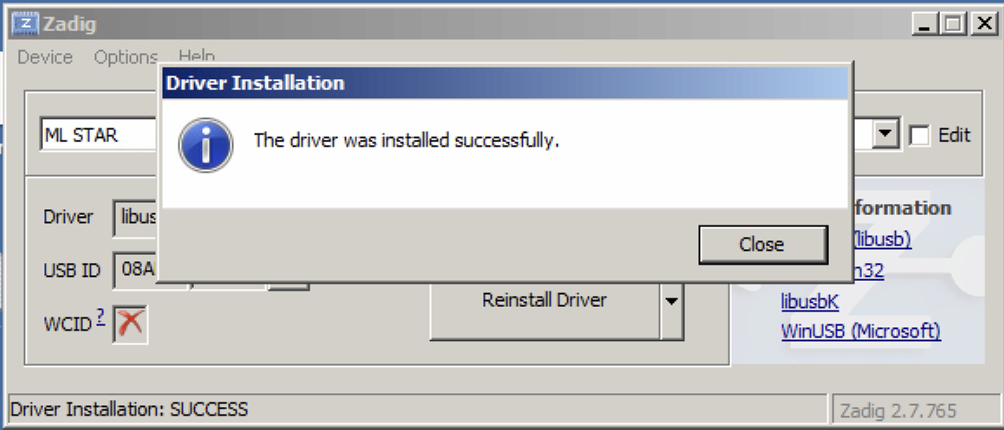

  1. Select “libusbK” using the arrow buttons.

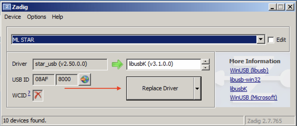

  1. Click “Replace Driver”.
  1. Click “Close” to finish.

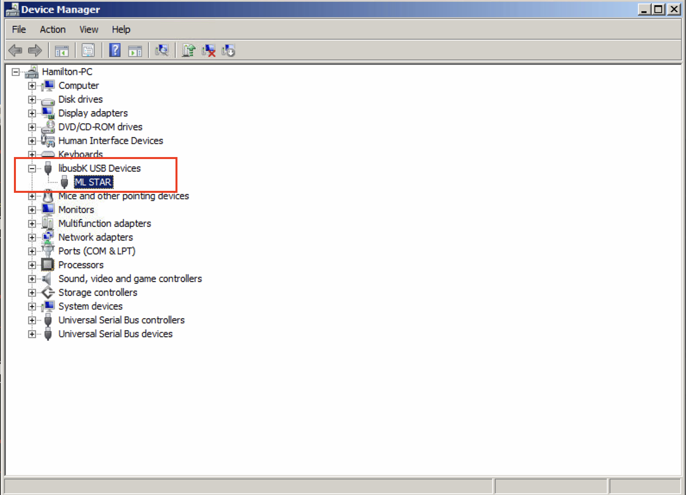

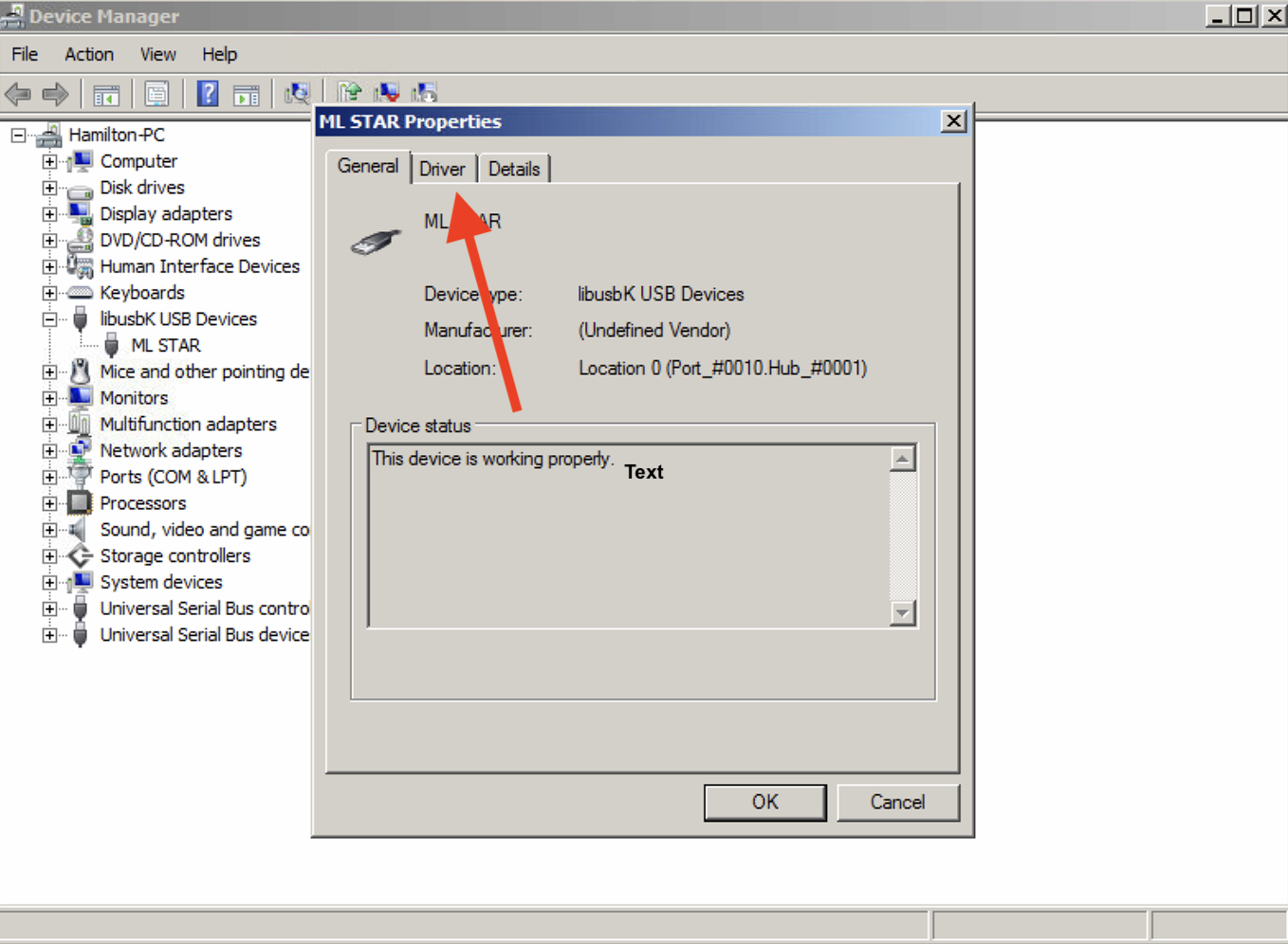

  1. This guide is only relevant if ML Star is listed under libusbK USB Devices in the Device Manager program.

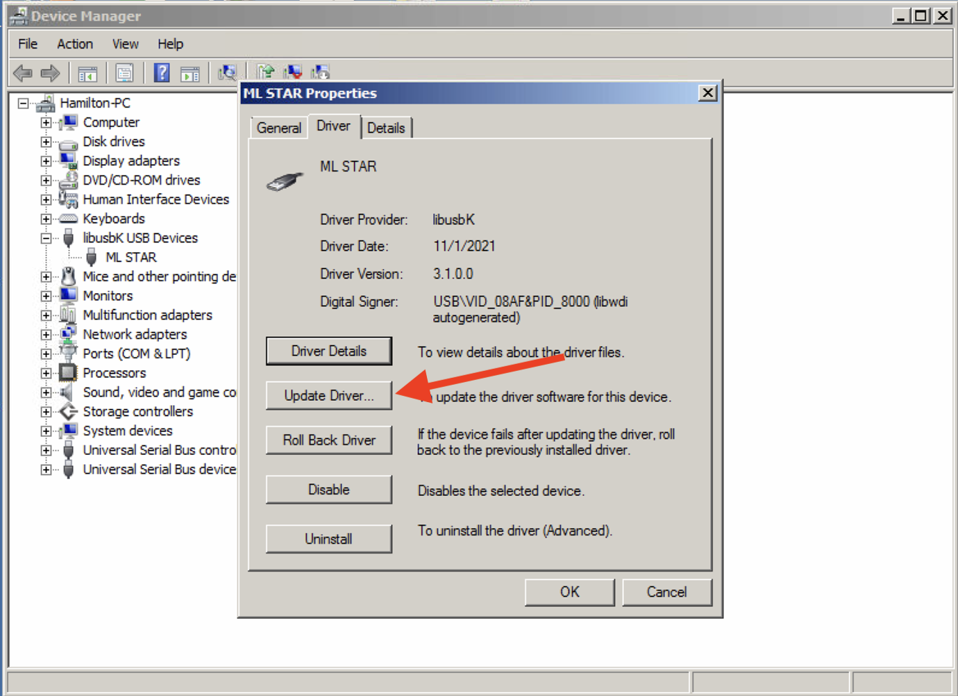

  1. If that”s the case, double click “ML Star” (or similar) to open this dialog, then click “Driver”.

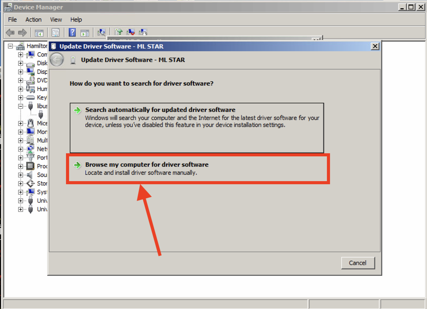

  1. Click “Update Driver”.

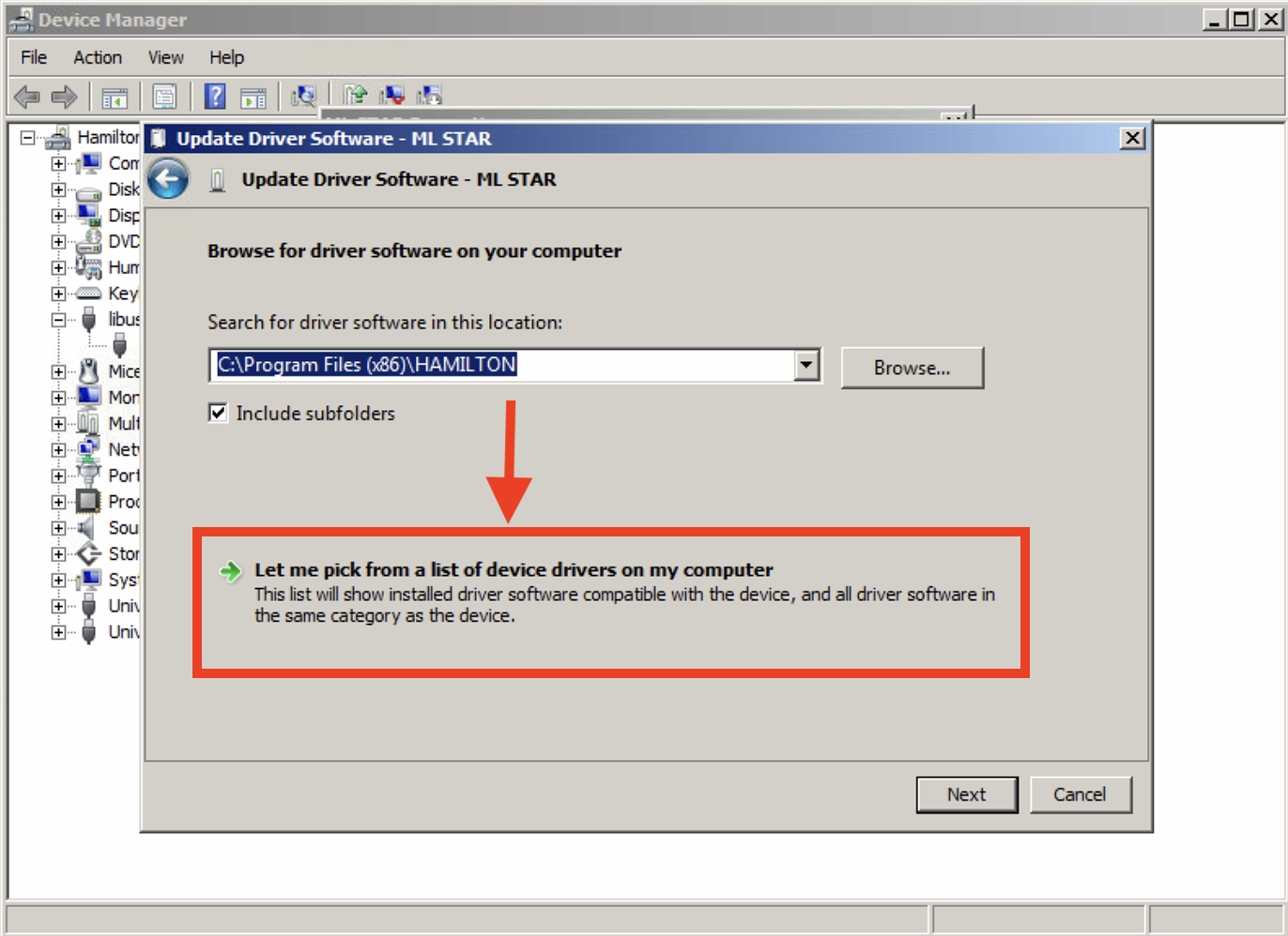

  1. Select “Browse my computer for driver software”.

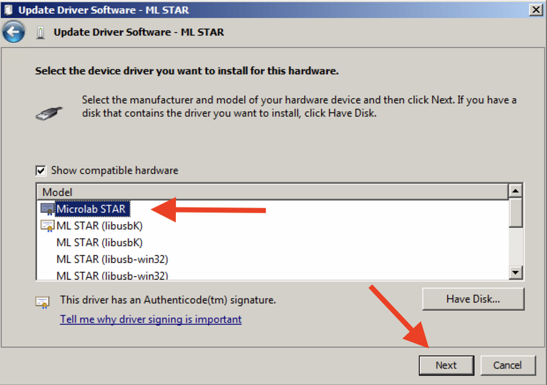

  1. Select “Let me pick from a list of device drivers on my computer”.

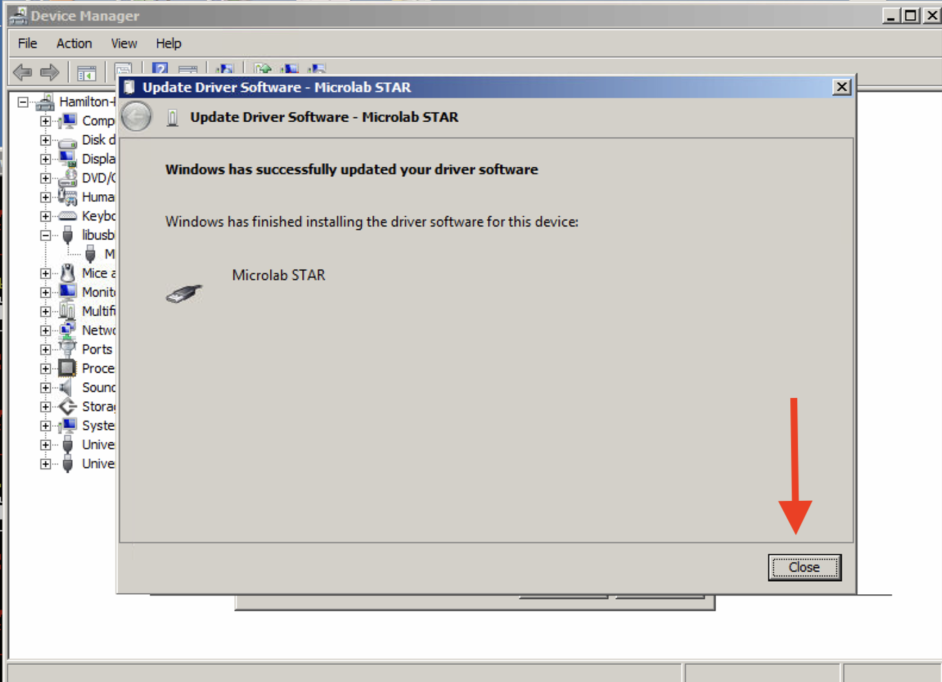

  1. Select “Microlab STAR” and click “Next”.
