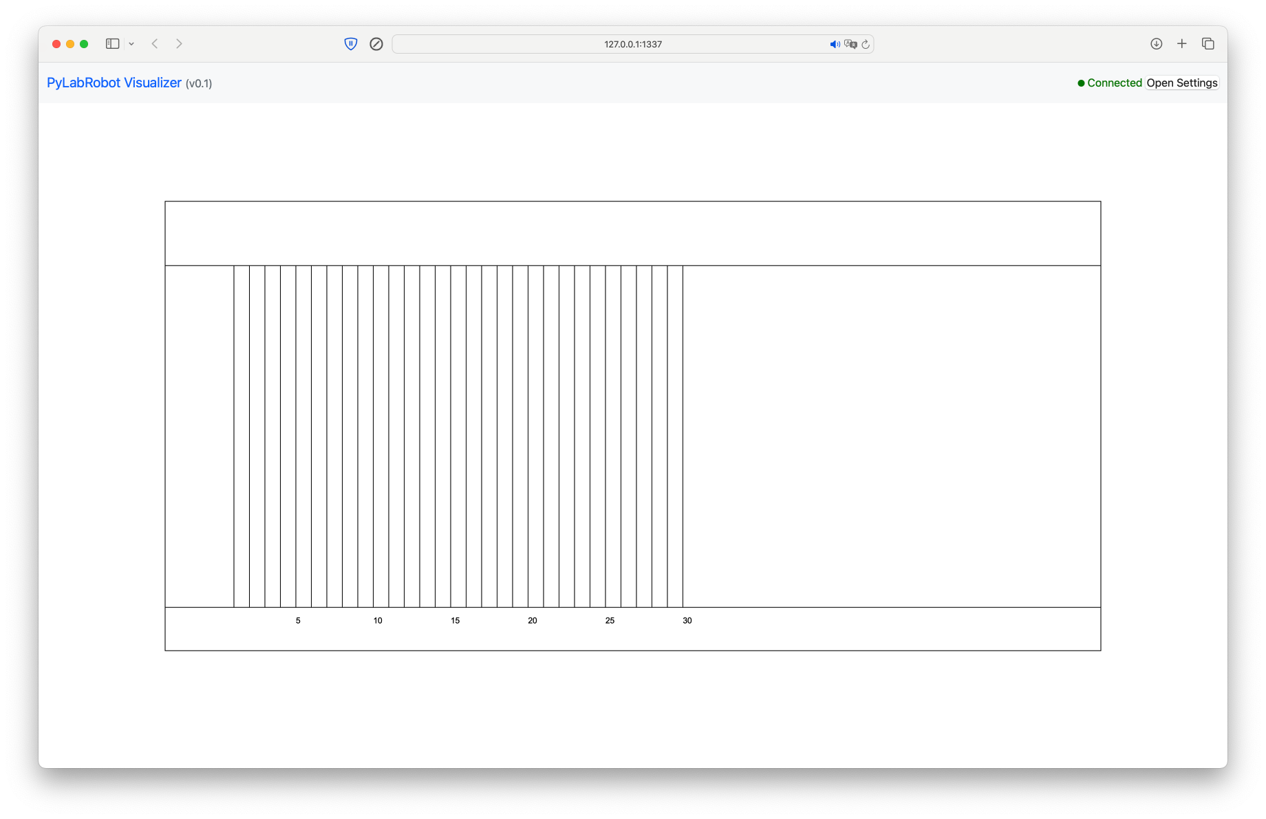

The empty simulator

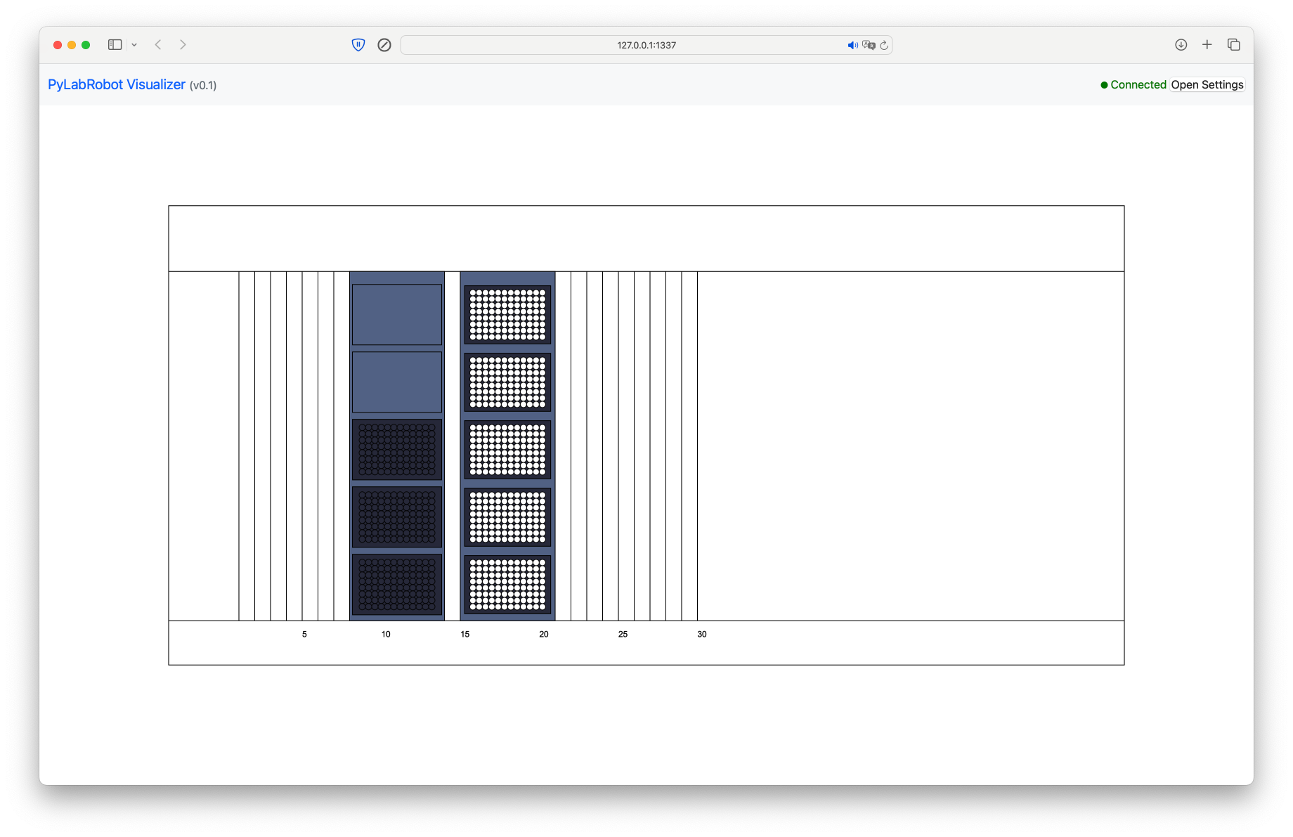

The simulator after the resources have been assigned

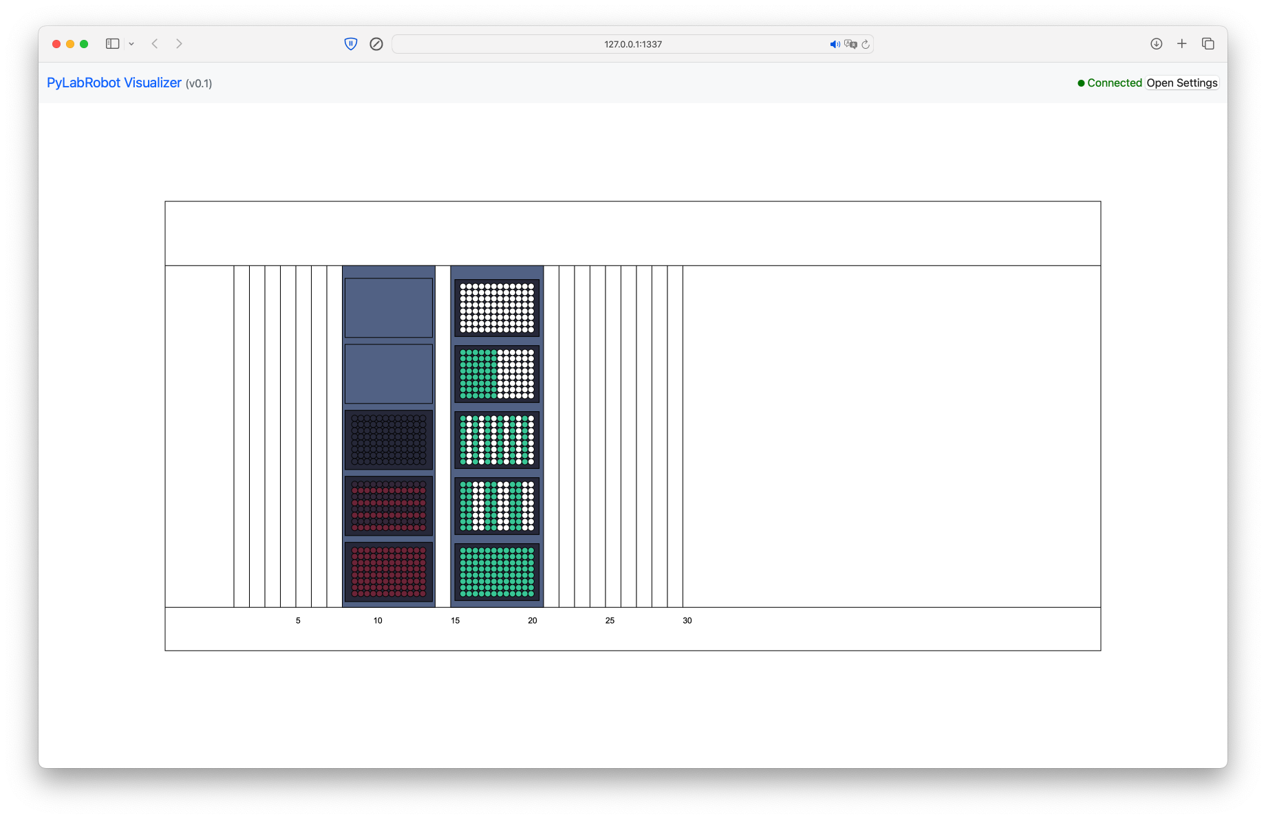

The simulator after the liquid handling operations completed
