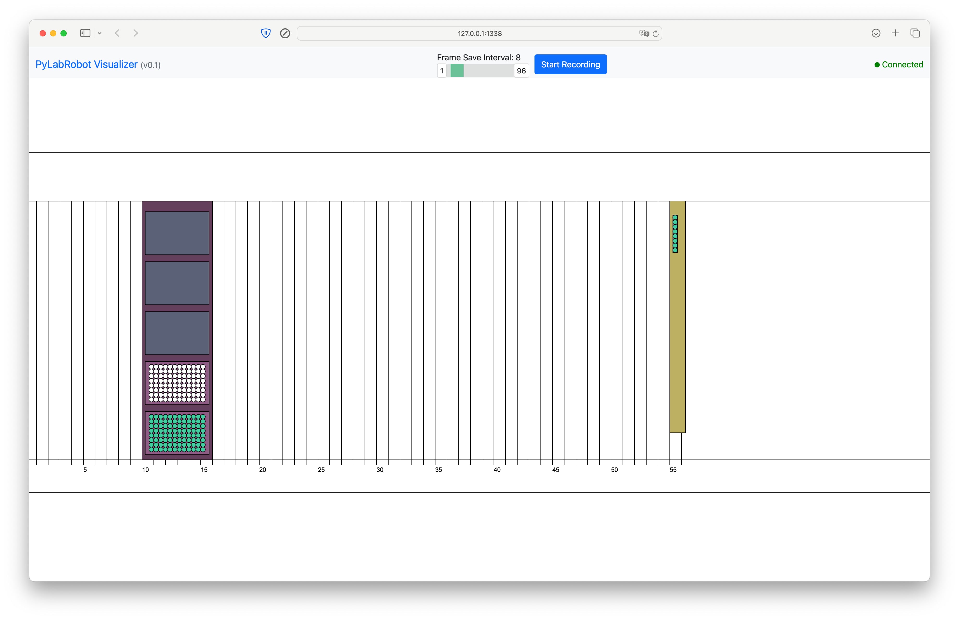

Setting up the visualizer#
Let’s use the visualizer to see the state of the deck.
from pylabrobot.visualizer import Visualizer
visualizer = Visualizer(lh)
await visualizer.setup()
It should look like this:
full

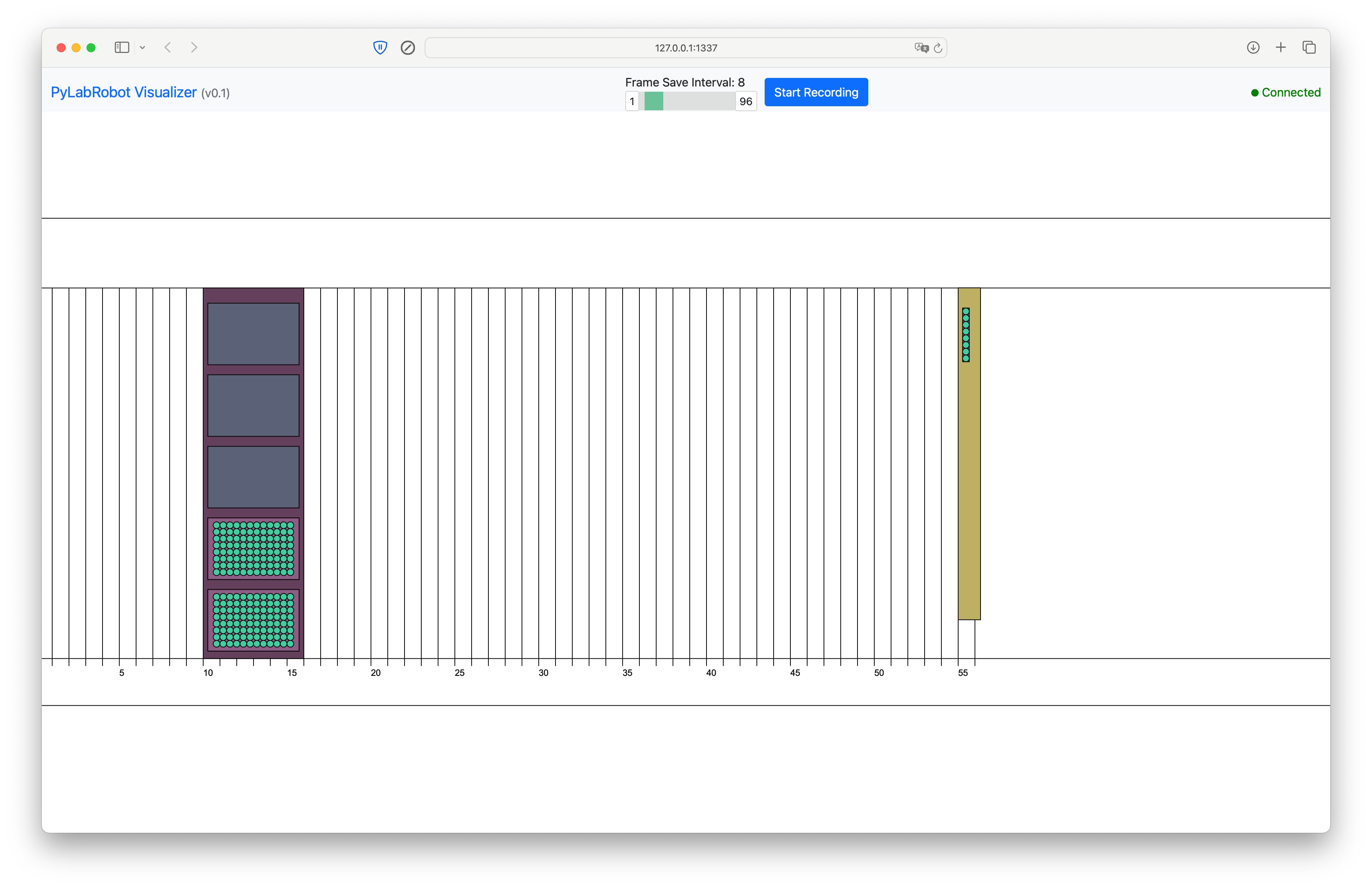

tr0.fill()
tr1.fill()
Now the visualizer should look like this:
full
