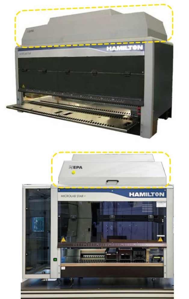

The Hamilton HEPA Fan for a STAR or STARlet liquid handling workstation has to be placed on top of the machines chassis.
It requires two cable connections to be operational:
Power cord (standard IEC C13); if you are using an older HEPA Fan model ensure that the voltage switch is set to your country’s mains voltage!
USB cable (USB-B with at fan end; USB-A at control PC end)
