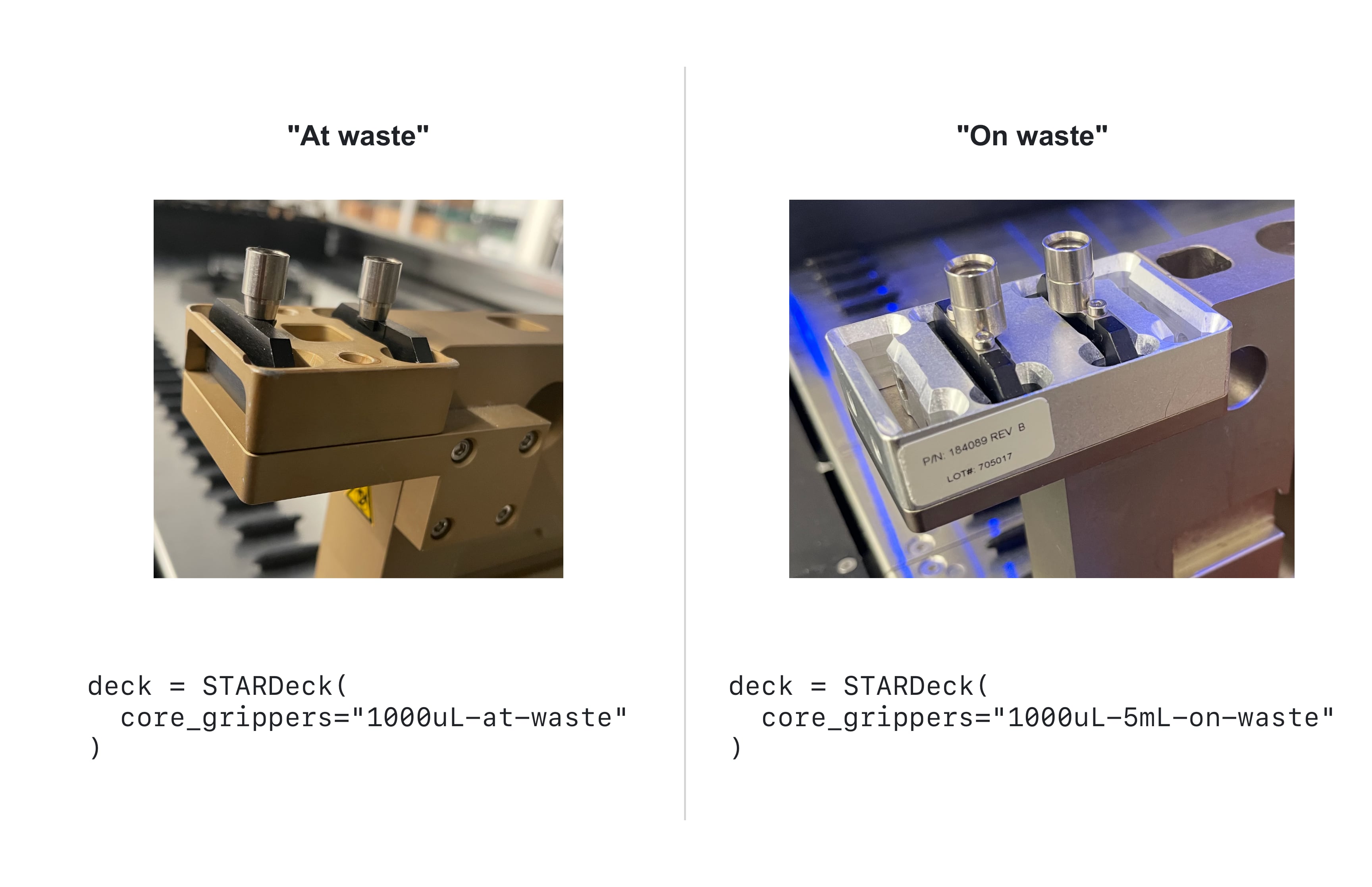

There are two different types of core grippers:
Co-Re gripper types
from pylabrobot.liquid_handling import LiquidHandler, STARBackend
from pylabrobot.liquid_handling.backends.hamilton.STAR_chatterbox import STARChatterboxBackend
from pylabrobot.resources import STARDeck  # STARLetDeck
deck = STARDeck(
  core_grippers="1000uL-at-waste"  # or "1000uL-5mL-on-waste"
)  # STARLetDeck()
# star_backend = STARChatterboxBackend()
star_backend = STARBackend()
lh = LiquidHandler(backend=star_backend, deck=deck)  # STARLetDeck())
