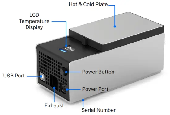

Setup Instructions (Physical)#
Connect with USB to opentrons or to computer running pylabrobot
